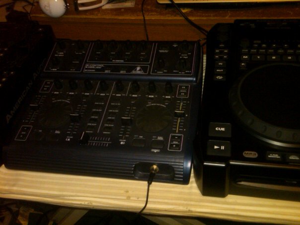

So, I removed my numark external mixer, and replaced with my BCD2000. Behringer to the rescue.
