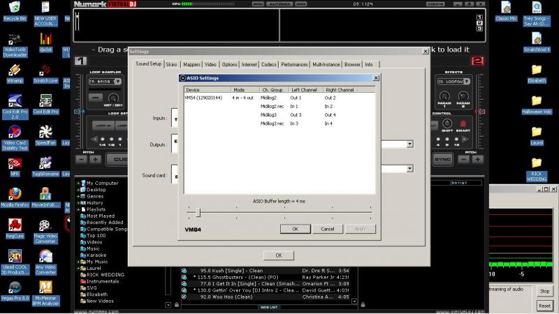

Can you post your sound setup please (screen shot) from the VDJ config menu?

to save time which all do you want screen shots of? config, TC sound setup, vms4 set?
it sucks cause the VMS4 works GREAT other than the TC pops i get.

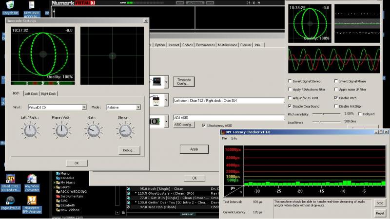

I would like to see your VirtualDJ Sound setup + the Timecode Setting + Timecode Debug windows. Thank you.

LOL come on man. i have done this. i know how to set it up, i know how to adjust latency, i know how to adjust audio settings in vdj, asio etc. i am NOT a newbie when it comes to djing, digital djing, djing with a laptop, djing with and without timecode etc etc etc. i search the internet and threads befopre posting questions/problems. i try suggested fixes out before and during postings etc.
today i will actually have time to set up the vms4 with a cdj so i can get some screen shots for you, which i'm sure it will look fabulous and be spot on where it should be. because thats what i looked at when i had the first problem, my TC.
i used the vms4 at the radio station twice and for a private gig the last 2 weeks without TC and i had NO PROBLEMS which was my initial intended use for the VMS4 anyway (NO TC) Using TC would be nice to get squared away just to have.
Other than the TC issue i am having i haven't had/noticed anything else so far. well the mic issue (still waiting on my adapters from AA)
geposted Mon 24 Jan 11 @ 6:33 am
as you requested i even included the dpclatency checker
Please let me know
Please let me know
