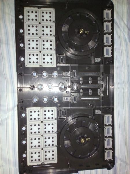

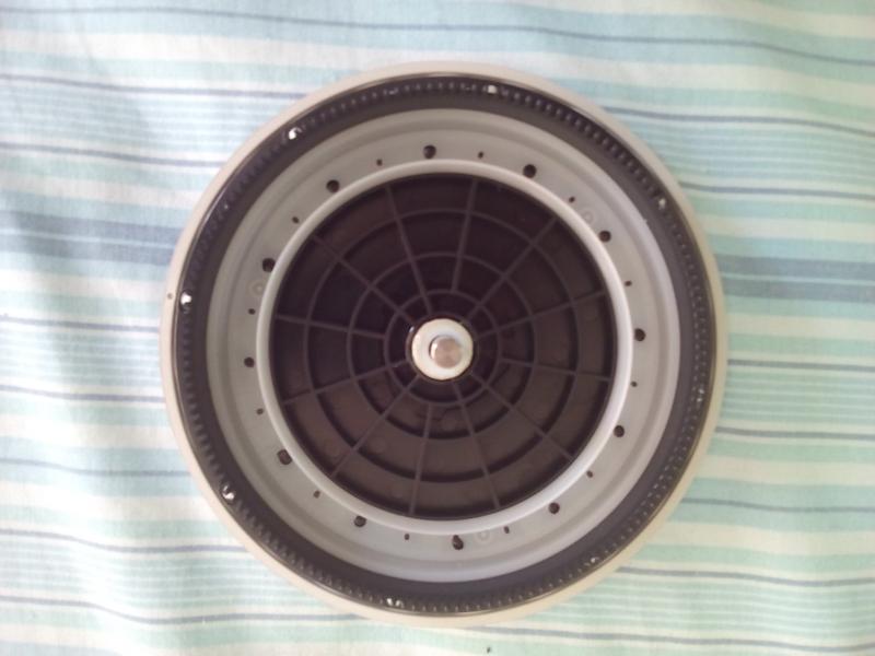

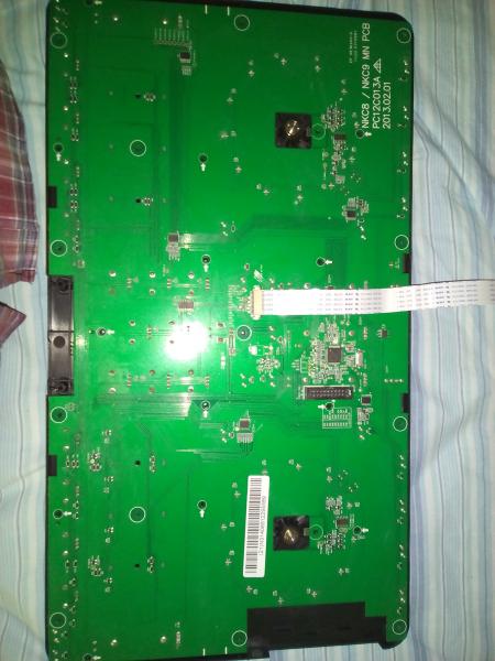

The problem is with the numark mixtrack pro II the jogwheels while in scratch mode they do pitch bend will turning in any direction slow down or speed up the track. The solution to this problem is a grounding issue i have fully disassembled mine to the bare if you remove the jogwheel that is causing the issue you will see a small white washer
that washer if it worn down then the pressure on the jogwheel contact will not be
you have to be pressing down on the jogwheel to actual getting it to scratch also ensure that the metal contacts
where the screws are use to hold the shell outer case are screwed in tight are change the screws to some longer ones
