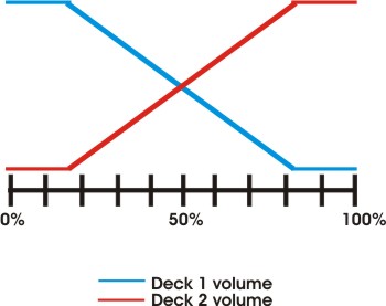

You can adjust the crossfader_curve by setting the exact behavour.
Draw something like this to show how your crossfader would like to respond and i will try to make the script for you. (And i say i will try because ihavent done this before.hehe)
geposted Tue 18 Jan 11 @ 8:49 pm
