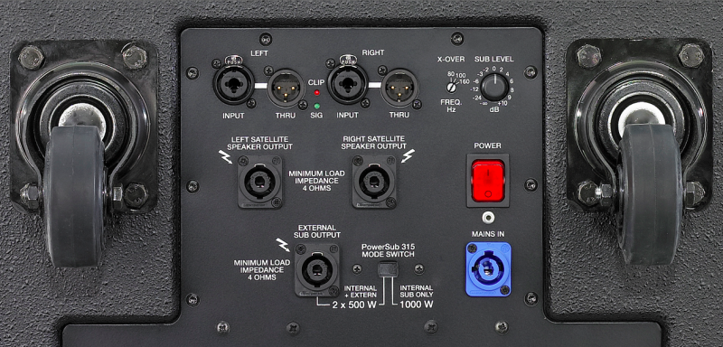

No you can't however you can do it the other way around with selected manufactures mainly German for some reason, active bass, passive top
