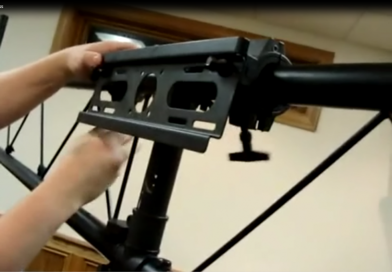

Anybody knows where i can buy this wall mount ,i asked the guy on the video but he doesn\'t know,he says found it on eBay but i can\'t find it, this is perfect for my truss... yess fellas i used Google ,eBay etc to find it but no luck.. i was wondering if anybody used so can tell me where to buy it..

Never seen it but it just looks like a modified wall mount for a tv.........maybe some kind of diy that's why your not finding it anywhere.

Hello,
for me this thing looks like selfmade.
He used a very basic wall mount and add two Thruss-Clamps with screws on the backside.
Greets, Heiko

That black trussing isn't safe.

I made a similar one using a wall mount bracket from Wal-mart and two Chauvet O-Clamps. ADJ O-Clamps are rated at 25lbs each while the Chauvet are rated 75lbs ea. Got smaller lenght bolts for attaching the O-Clamps to the wall mount and done.
how that turns out... i mean it is safe...do you have any picture

Get a wall mount kit from ebay for cheap. look for dynex dx-tvm112. then get two O-clamps from AMD or any other brand.
I use this and it works great. i have a 32" flat lcd tv
