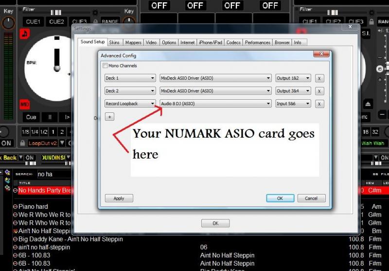

Hey Beat breaker can you give me a visual of the recording solution. I am a vision type person. Thanks. By the way I have a Numark ASIO soundcard.
geposted Wed 29 Jun 11 @ 5:20 pm
Try it like this and let me know if it works for you,
Run a line from your BOOTH OUT into your NUMARK ASIO card. You might have to record for a min or 2 to check your levels if your card doesnt have a VU Meter on it.
Hope that helps
Huey
