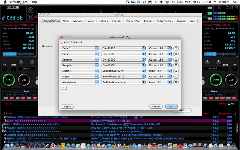

1. go to the two Denon DN-S1200 players and set them both to MIDI CH SET 1.
2. Create the Aggregate. Try this link to certain extent to learn how to do it: http://support.apple.com/kb/HT1215
Note that channel 2 is added first before channel 1 in the advance audio outputs config in order to make left deck and right deck work accordingly.
3. Open Virtual DJ Pro 7 and go to Outputs Advance config. add those audio channels like in this pic
4. You only 2 channels for the two denon DN-S1200s. Adding the rest of the channels are optional.
5. Go to Mapper Options and set deck 1 to DN-S100 1 and Deck 2 to DN-S1200 2

Certainly, In audio Advance only use the two DN-S1200(asio) and not the aggregate.

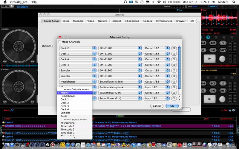

Now, for myself I use 4 deck skin using just my 2 Denon DN-S1200s. It Is a bit tricky at first to set them up, but work like a charm for me now. I hope to one day add the instructions to the wiki if Virtual DJ Pro 7.2.+ up does not make too much changes to the current audio options available.
Note the eject button on the DN-S1200s can be used as the button to switch those 4 decks on a 4 deck skin. It is currently mapped that way in the default mapper in Virtual DJ.

A little bonus. Pic of the audio Advance coonfig for 4 decks:
