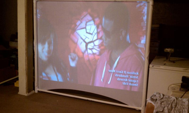

Well had been thinkin all day about a truss system for a screen...........so on my way home from work I pasted the soccer fields and boom it hit me like a ton of bricks!!
Why not buy a soccer goal and just stretch the screen in front of that!! Well I called around and nobody sells small goals. So off to Home Depot for some materials.
Came home, grab my son and got to work. Well this is what we came up with so far,
It\'s about 8 1/2 foot tall by 6 1/2 foot wide. Diagonal is about 8 foot inside. In the picture I didn\'t have the base on so the string from the ceiling is holding it up, Lmao!! Anyways this is my first attempt and I think its gonna turn out pretty good.
Thanks for the time
Huey
Thanks for the time
Huey

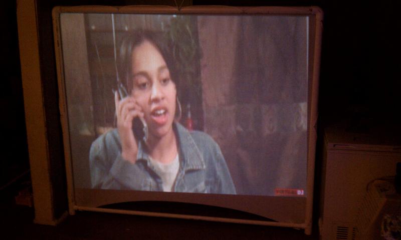

Well heres a little update,
So let me have it, anything I should change or add, feel free to tell me,
Huey

Looks decent. left some comments on your video.

Now when you say "Hot Spot" are you talkin about the spot where I can see them light from the projector? Where it comes out of the lens, like your staring at the sun, lol!!

that's exactly what I mean, Hot spotting: concentrated projector light coming through the screen.

And I bet that's because of the rear projection and the type of cloth I'm using. I'll have to try out different ways of setting it up. For most of my venues we are usually up on a stage so I think once I get rid of that ceiling mount it shouldn't be so bad from the crowds perspective, I hope, lol!

if you keep the projector low and angle it so the hot spot is above people's eyes, they won't see it. hope that sounds right. I had same problem before.

I wouldn't get over-excited about it really. There's a trade off going on there, The material must be thin enough to accept the rear projection and still have a useable image that can be viewed in a semi-lit environment.
So the spandex is actually the best material; but that hotspot is the bad that the good goes with.
Unless you spend about 800.00 on a dalite rear projection surface

Hotspots are usually caused by a poor screen material, a hot spot happens when light get reflected back at the projector. Fixes for this are pretty simple better screen, or use your brightness control to try and even it out, moving the projector will only result in moving the hotspot. Guys there is a reason why Rp (rear projection) screens are more expensive then spandex and this is one of them. The material they use has good color retention, high transmission and low reflectance properties.

Thanks for the info. Just ordered a better screen, one that's made for rear projection. Atleast that's what the website said, lol!

Hi Huey
I got my screen from Djscreens.com and while its a bit costly, its worth it. Works great for rear or front projection. I wanted to let you know that you can look for an additional lens to mount on the projector that will cut the throw distance to about 2' for the same screen size. I have an Optoma projector and last time I checked the lens for mine was around $300.
