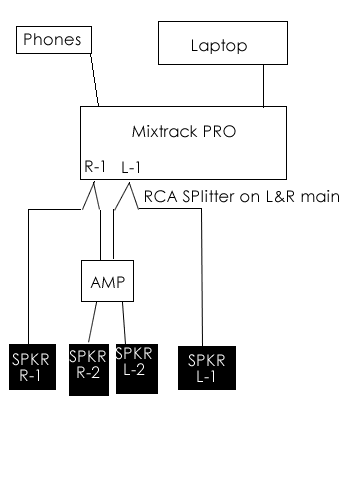

Hte mixtrack pro is an odd beast. the 2 outputs don\'t work the way you think they should. re-read the owners manual -don\'t have mine in front of me - I believe one is only good for cueing so you can\'t use it if you have headphones plugged in. that is why you will need splitter cables if you are running 4 speakers. Ran mine that way for a while but eventually just pulled the plug on the 2nd set. what kind of set-up are you running? You have 2 powered speakers and and 2 passive speakers on an amp? Do your powered speakers not have pass through outputs? What is the physical arrangement? are they in separate rooms? What model speakers and amp are you using? In my experience with the Mixtrack pro RCA splitters from the main output are the way to go. You have to separate your RCA cables into single strands though to run the L/R to the proper sides and keep them color coded.

I would not run a full output channel to the 10" mains as long as you are running it with the 15" subs. Making the subs try to reproduce the mids and highs is bad and making the mains reproduce the lows will likely blow them or distort it in a way that will be tough to listen to. Because you a re running out to a powered speaker I don't think you can use the built in crossover in the CPL55 subs. the extra power would likely blow your mains. get a set of passive inline RCA crossovers. One set with a high pass filter to put in line with your mains and another set with a low pass filter to send the signal to your subs. While not as good as an active crossover they should do the job decently in your situation.
High pass:
http://store.hlabs.com/pk4/store.pl?view_product=10
Low Pass:
http://store.hlabs.com/pk4/store.pl?view_product=9
I think the 100hz models in each type would work well for you. They just plug inline with your RCA cables

Mixtrack pro is great to start with - Check out the diagram I posted earlier in the thread and remove the 2 extra speakers and splitter.
