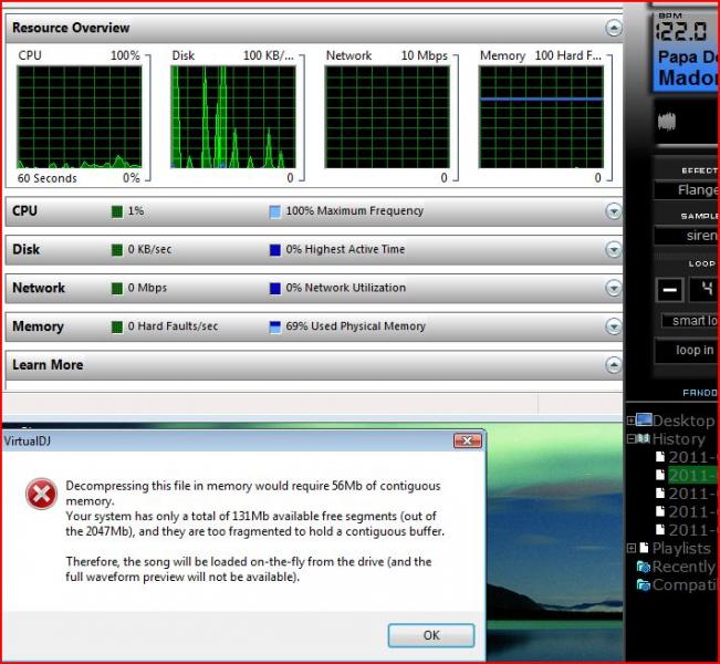

When I load a file in eigther deck. I get the following message
Decompressing this file in memory would require 58mb of contiguous memory. Your system has only a total of 227mb available free segments (out of the 2047mb), and they are too fragmented to hold a contiguous buffer.
Therefore the song will be loaded on the fly from the drive (and the full waveform preview will not be available. )
Happens with mp3s. And vids. Help please.

This has nothing to do with 'disk' space. Read the message again - it has to do with 'contiguous memory space'.
Your system only has 2Gb of memory - (out of the 2047Mb) - and you are trying to load a file larger than 58Mb in size.
Were you trying to load a track that was longer than 30+ minutes in length?

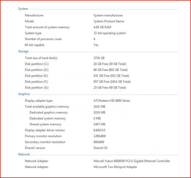

vista home is not compatible with 4 Gb and as you see in your screenshot it only shows 3.25GB ram so anything more then that is a wast of ram(money) because the os can't see it or use it. the problem seams to be that you system actualy only reads 2 gb of the ram
geposted Sun 27 Mar 11 @ 3:19 pm
thank you, tere is an issue with this mb seeing all the ram.. the origional drive with the same instal see all 4gigs . why is it seeing all in one and not the other.... but anyways home isnt working on this drive.. what version will???

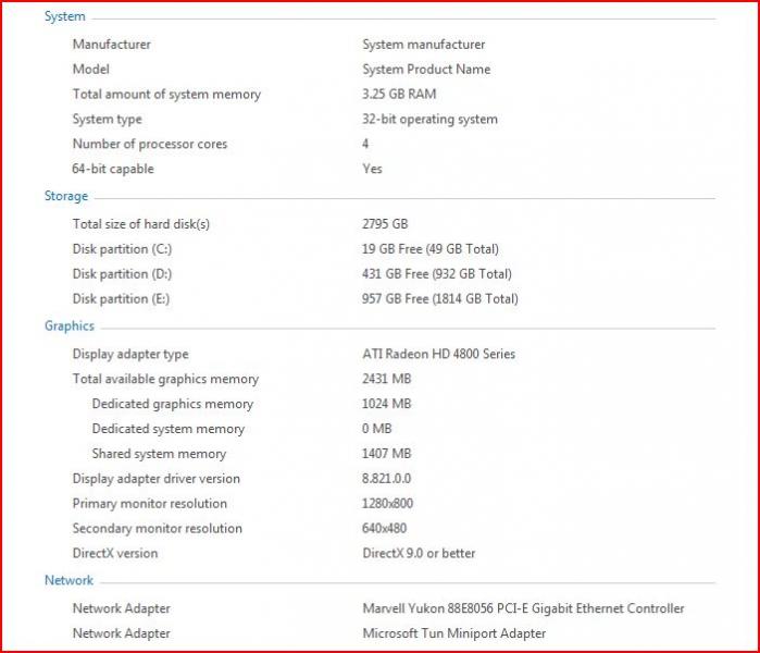

gullum wrote :
vista home is not compatible with 4 Gb and as you see in your screenshot it only shows 3.25GB ram so anything more then that is a wast of ram(money) because the os can\'t see it or use it. the problem seams to be that you system actualy only reads 2 gb of the ram
just for the record,, this is from the origonal drive OP
geposted Sun 27 Mar 11 @ 4:25 pm

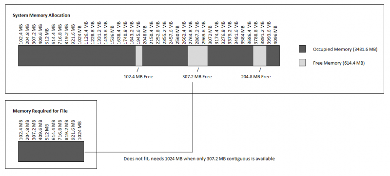

Vista Home does support more than 3.25GB of memory - providing you are running a 64-bit version. This is true for Windows XP and 7 also. Changing your drivers will not help with the problem and is not recommended if your system is performing well already. The issue is as cstoll described. I have made a diagram which I hope helps (the numbers are for demonstration purposes):
Edit: On looking at this problem a second time, perhaps drivers are an issue here. Virtual DJ is only seeing 2 GB of memory. I wonder why that is?
