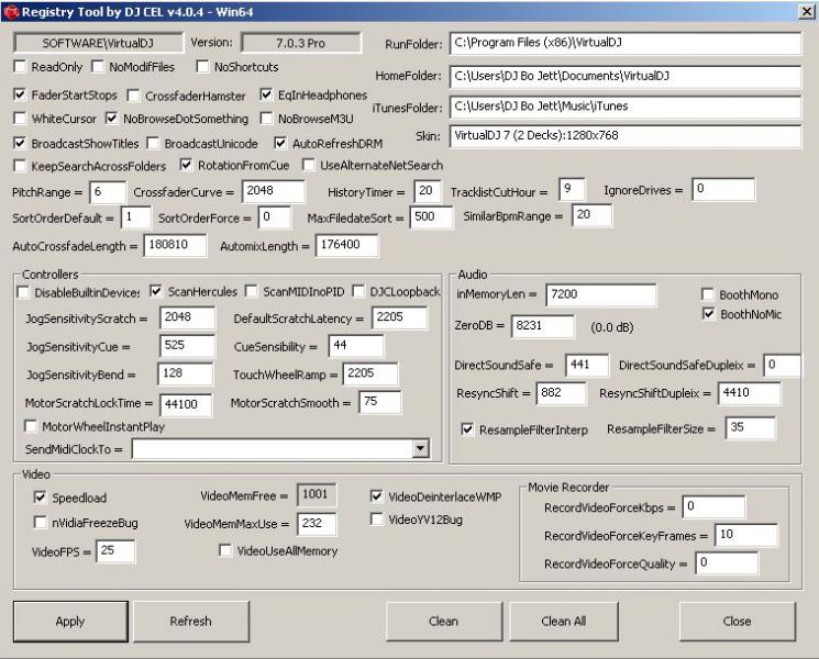

@ Voodoo
Have you tried the registry tool? That fixed my freeze problem awhile back. Also make sure you download the latest version of the registry tool.

DJbojett, you have in VideoMemMaxUse=232. Did you put that value in, and what does the value mean?
geposted Mon 18 Apr 11 @ 12:48 pm
I was told to put that value in sometime ago in the forums. When I set that to 232 my video freeze stopped. I have a 1 gig video card and i believe 232 is like a 1/4 of the video card.
