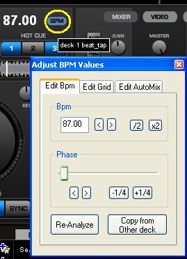

Make sure the cbg grid is in the correct position, if it needs adjusting you can right click the bpm button on the default skin to be able to adjust the cbg. Another good tip for adjusting the cbg is to create a metronome track that you can sync the beats to so every track you fix is locked to the same beat. I made one in fruity, but any daw would do it fine.
You could also map a couple of buttons to - adjust_cbg -0.01% you can use +/- and if you want the button to be more sensitive Increase the % value

what is the cbj ? I did not understand exactly how to perform the operation of the grid fix And how do I know that he is incorrect Right now ?
geposted Thu 12 May 11 @ 9:08 pm
sorry, the cbg stands for "computer beat grid", its the thing at the bottom of the waveform, vdj will sync tracks to that. It would be necessary to adjust if the tracks were galloping or out of sync e.g. the bass is where the snare is on the other track.

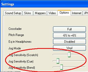

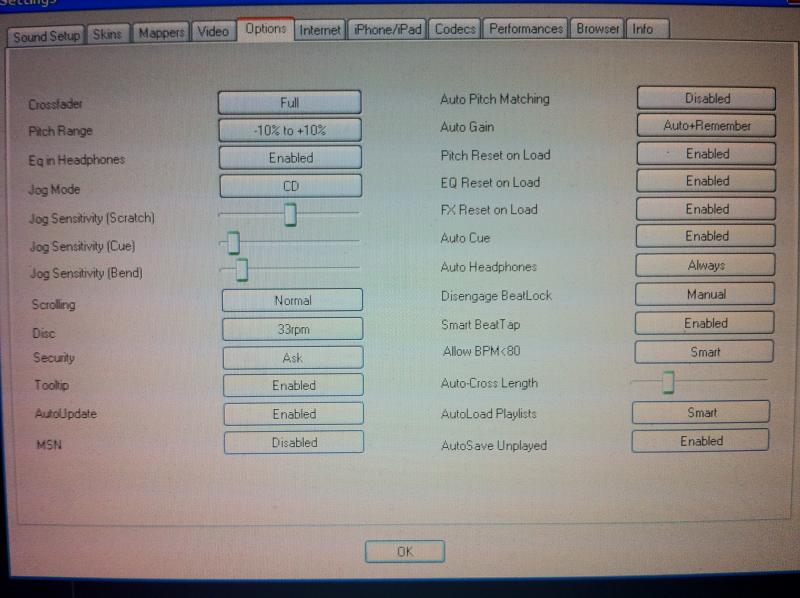

my jog sensitivity is very low He tuned according to my convenience

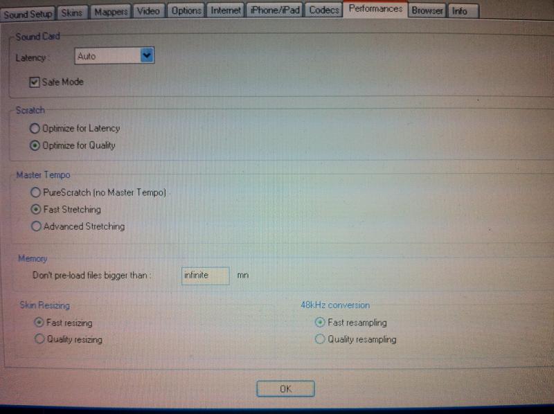

I still have no idea... LOL, maybe your latency is too high so your audio is breaking up, I use serato tcv with an audio 8, and get the tracks to match every time, unless the ground goes, in that case the pitch will fluctuate wildly up to around 1.5 higher until i reground the deck.

my latency is less then 4ms. for the test we used jbl 15" monitor With the same volume with both softwares
the feel was that the serato sound was softer what made the beatmix to sound Better and faster to get.
I know that sound has an effect on how the mix will hear and in the test I could hear the difference Between softwares
Could be something in the settings that I'm missing ?
