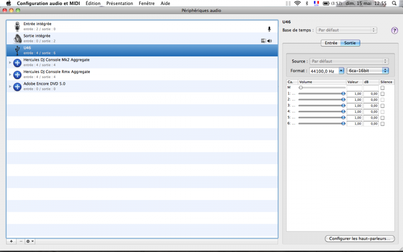

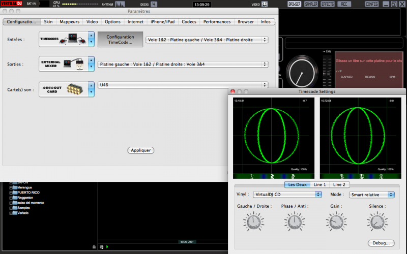

The only thing you have to do on your Mac is that
And that
and on your VDJ that
Don't do anything more mystic...........
Chris
And that
Chris
geposted Sun 15 May 11 @ 11:11 am
