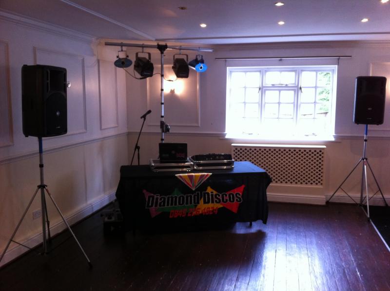

Winch stand and 48mm tube, also put your lights on 50mm clamps.

@ Charlie that setup looks very nice. I think I will go with a T-bar stand like that rather than a truss. Which model lights are you using there?

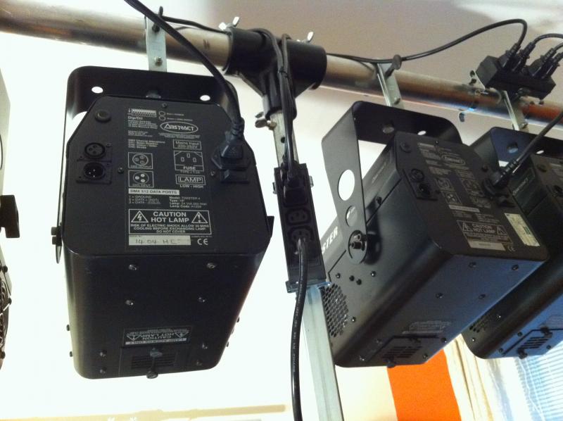

Hi Mate,
Lights are made by Abstract, UK made but I doubt you get them over in the states.
Actually the manufacture went bust after all this cheap Chinese stuff came out, shame.
I wouldn't buy that ADJ stand, it's a typical cheap DJ setup and there dangerous, you need a well made used stand. I don't know who makes decent stands in the US? thought you might of had a better response from the community and fellow citizens.
As in my original post: Winch Stand and 48mm tube, also put your lights on 50mm clamps.
A good rule is not to buy a stand that is painted black lol, is always cheap, thin, Chinese crap. Also the joints are always plastic!
