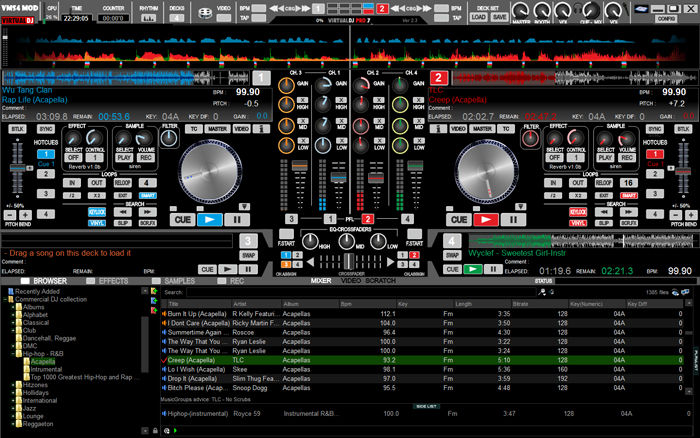

Ok, starting to finally love more than two decks!! It never fully worked well for me. But made a small modification on my hercules RMX map file, just the CUE buttons to swap desk, and made some small modifications to djdads great VMS4 skin (four deck Rhytemgrid and crossfaber configurable between all four decks) and it works like a charm!!!!
Was playing around with the instrumentals, mixed with acapella rap and acapella vocals and it sounds very promising!!! It does require some practice :P

......I looked for your deck under the downloadable skins....I can find the VMS4 skin, b ut not the one with the "silver" jog wheels.....Any ideas why?.............Also, could you post your RMX VMS mappings?......I would definitely appreciate it!!.... =D

@jusblaze246: Its 'pending review' meaning Atomix needs to take a loot at it before it hits the skin section. I'll put a message in the thread when released. But remember its a adjustment to the Skin of DJDAD, don't wanna steal his thunder.
For the RMX mapping, only thing I changed on my mapping was the 'cue select' button, that either switched que or swaps deck:
<map value="PFL" action="select ? device_side 'left' ? deck 1 leftdeck ? on & deck 3 leftdeck & deck 3 select : on & deck 1 leftdeck & deck 1 select : deck 2 rightdeck ? on & deck 4 rightdeck & deck 4 select : on & deck 2 rightdeck & deck 2 select : select" />
