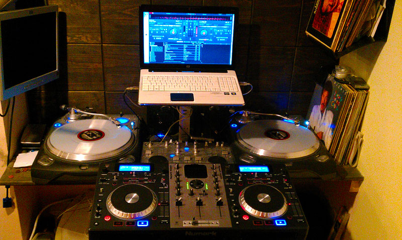

I want to use my RMX as a soundcard so that i can scratch with turntables, but i want to use the mixer and CD players of the Mixdeck....
can this be done? point me in the right direction in terms of settings pls... :)

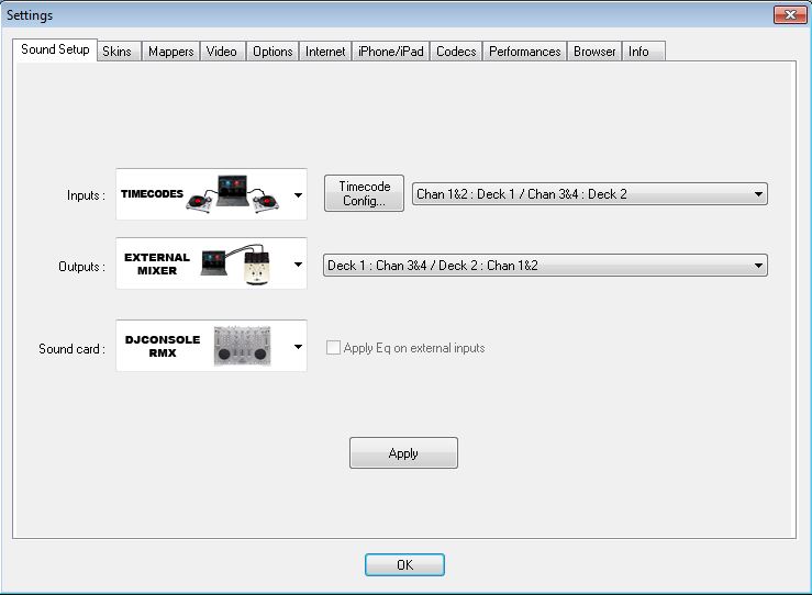

so those are my settings in vdj...
i have the 2 TTs connected to the RMX, everything works fine with the tcvs...
from the back of the RMX i have outs 1&2 and 3&4 going into the Mixdeck AUX inputs...
[on the mixdeck now]
Aux in 1 is set to line - works great
Aux in 2 is set to phono - sounds lousy but line wont work....
geposted Mon 20 Jun 11 @ 10:37 pm
::::: SOLVED :::::
The sound problem was the fader in the RMX (its shot). i just deleted its function through the mapper and its running like a dream :)
same setup as above, but both Aux Line Ins are set to Line on the back of the Mixdeck....
still curious to see how i can use the tcvs through the mixdeck though.....
geposted Mon 20 Jun 11 @ 11:11 pm

lol yeah i usually dont take the TTs out. lately ive been just taking out the rmx (until the fader died) or the mixdeck.
im impressed with the mixdeck... if i would be able to use tcv through it it would be the perfect machine.
I was asking because i was starting to miss the feel of vinyl :) and the cool thing is that now i can play lionel richie again... lmfao
