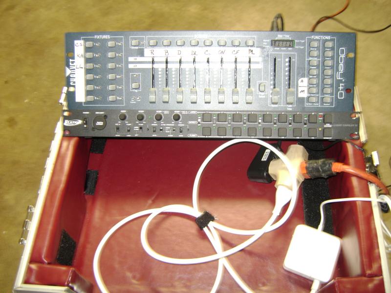

I try sound activation( slave lighting ) with my lights and it didn't give me the view looking for so I sold all my sound light but 3 and got all DMX lights with a obey40 controller now i can do sound activation with the DMX controller or I can program scenes and banks and color scenes with my obey40 DMX controller.

this What i Got also.

Your best bet is too get the freestyler software and a USB to DMX dongle.. or a hardware DMX controller like the one pictured above (though freestyler is cheaper and easier to program)
