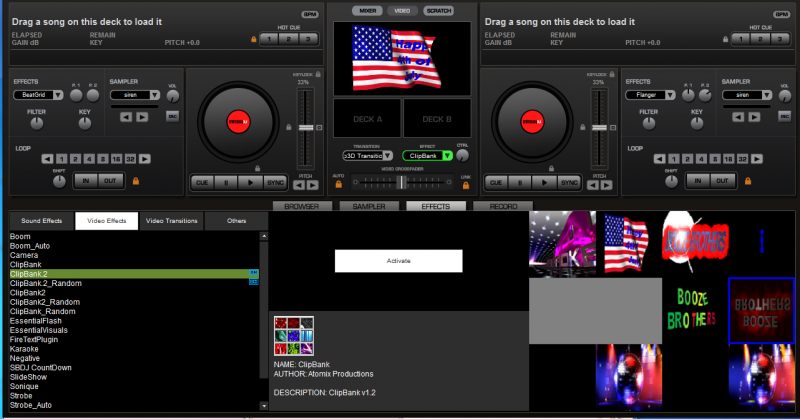

Has anything changed in version 7 for duplicating clip banks? In version 5.xx, I had multiple clipbanks... maybe 12 or 15 total. I just copied the standard clipbank DLL and renamed it, and then re-loaded it with new clips. The DLL would then generate the BMP file to match the DLL name.
But now I am rebuilding my banks in Version 7, and when I copy the DLL and rename it and reload it, the bitmap that is created remains as clipbank.bmp - no matter what the DLL is named. That means that every clipbank I create has the same thumbnail selection preview box.
Am I doing something wrong?

Guys, all you need to do to get multiple clipbanks without having to shut down is follow this (I'm running 7.4)
go to your plugins > video effects
locate the original clipbank > .dll - PDF & BMP files
copy those three files and paste them some where convenient like your desk top
rename each one the same such as clipbank.2 or whatever you choose to name it
after you have renamed each one exactly the same copy and paste them back into the plugins > video effect folder
repeat this process with the original files on your desk top until you have the required amount of clipbanks that you want
you can now open up VDJ and activate either your original file or clipbank.2 and load up and play, remember to deactivate your running clipbank before activating another set of clipbanks
you will not have to shut down VDJ during a show if you follow that proceedure.

Yes that is exactly the procedure I am doing. But everytime I paste the group of 3 files back into video effects folder And then select one of the clipbanks, the system proceeds to write a new the bmp file for that clipbank called clipbank.bmp. So while I have clipbank1.dll, clipbank 2.dll clipbank3.dll,etc.... they all generate only one bmp file called clipbank.bmp. therefore they all show the exact same preview box.
And yes... I do get greyed out boxes for some files.
