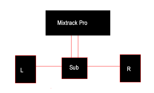

Typically you would use a set of RCA (red/white) outputs from the Mixtrack Pro and take each one ( red or white) to each speaker\'s Mono RCA input. Some speakers do not have RCA input but only XLR if so you will need an adapter to connect them. If you need to go int a sub also most subs have pass through output so you connect your full output RCA\'s (both red and white) into the sub and then send the white output to one speaker and the red output to the other.
Does each speaker have it\'s own inputs or are they like some Computer speakers that daisy chain off each other?

Jbart, I don't know yet, I didn't think I could connect powered speakers to my mixtrack with a sub because I have been using non powered with an amp & running the mixtrack into the amp then from the amp to the speakers because I didn't know that I could figure out a way 2 run powered speakers 2 the mixtrack pro, but thx your diagram helped a lot....
