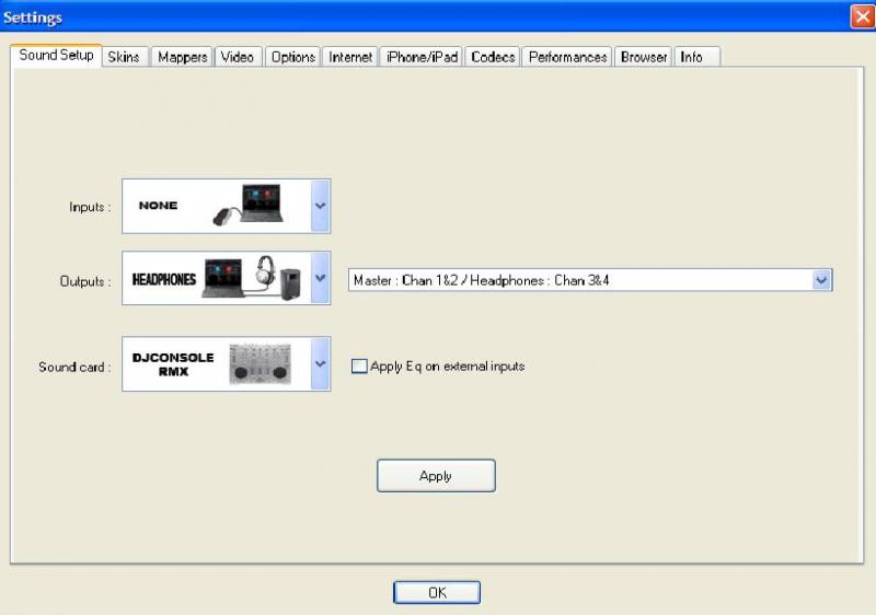

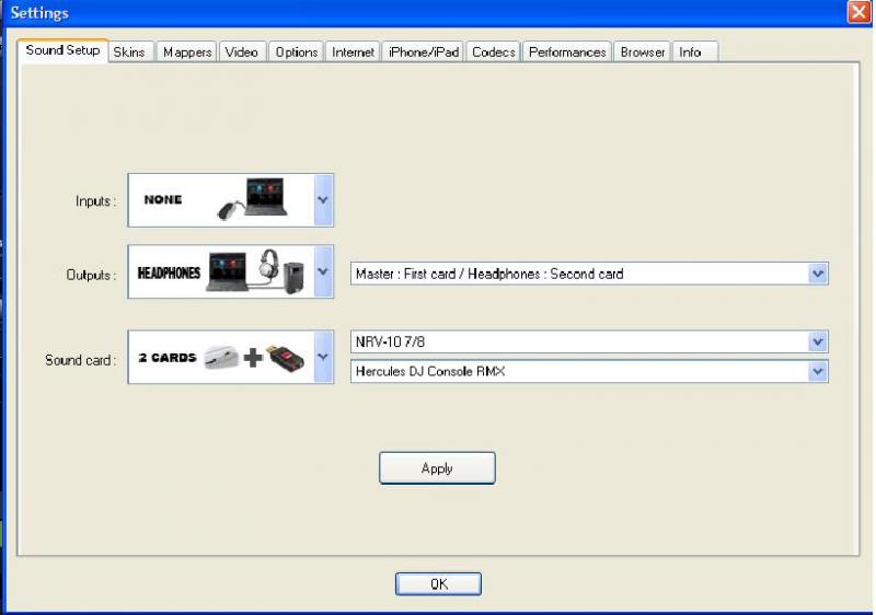

Tried these setting and still nothing, only works in a single card setting for both Master and headphone...
This setting does not work...
This setting doesn't work eithere...
geposted Thu 04 Aug 11 @ 9:50 pm
Yes, on the headphone monitor pot there is a "Mix" and "Cue" setting, but only works with the single soundcard setup below and I'm using Two soundcards setup which doesn't work so far...
Can someone confirm this by trying the soundcard setup ^above^....

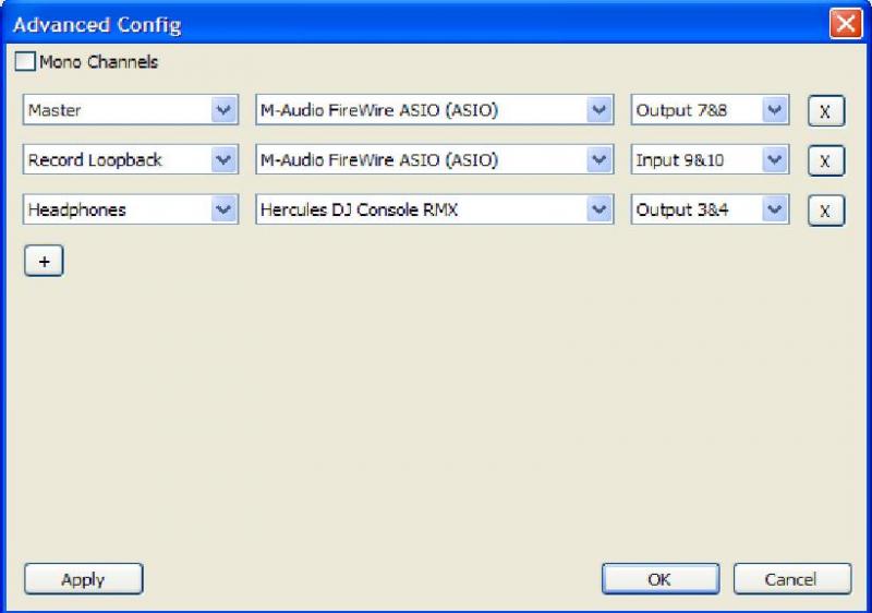

Dam, just installed 7.5 hoping that woud solve my Rmx headphone problem and still can't get it to work with a two card configuration,
Can someone tell me if this is possible using the Herculer Dj Console Rmx as a second card just for headphones, using channels 3&4.?

Try opening the Hercules control panel and switching the setting from WDM to ASIO. Then reconfigure inside the software using the Hercules ASIO drivers instead as it looks like it's currently set in WDM mode.
geposted Mon 08 Aug 11 @ 9:26 am

@superaceman
This will present a problem if you look at my advance settings above, because my Master NRX-10 soundcard mixer has a ASIO driver that is running, so if I also activate the Rmx ASIO driver this will cause a conflict in soundcard settings?
Am I right about this..?

no, you need to set the 2 cardds options first before setting your advanced options, this should allow you to route mains via one card and phones via another.
geposted Thu 11 Aug 11 @ 1:13 pm
You don't need to set the 2 card option, that's the whole point on the advanced config, so you can route your soundcards. Atleast in my mind it makes sense, plus I've never had to set it to the 2 card option and then do the same in the advanced config.

Can you give me a step by step how to get the souncard config to do what you are decribing, once you set a two card setup you can't go into advance, unless there is a specific way of doing it, which I haven't figured out...
Thanks,
Joey....
geposted Thu 11 Aug 11 @ 4:14 pm
i just setup the 2 card way, then goto advanced as usual and route my audio through which ever channels i want.
geposted Thu 11 Aug 11 @ 4:52 pm
Can you post a jpg image of your two card config and advance setup, and what ver. of VDJ are you using?
Thanks,
Joey...
