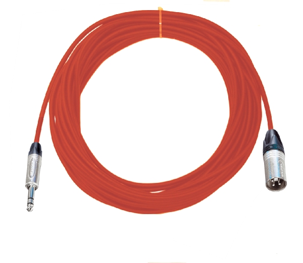

Hi mate
I would suggest you avoid using the adaptor. The Jack outs on the RMX are balanced TRS (Tip,Ring,Sleeve). To take advandage of the higher noise rejection performance of balanced line use a cable like this.

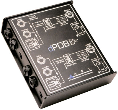

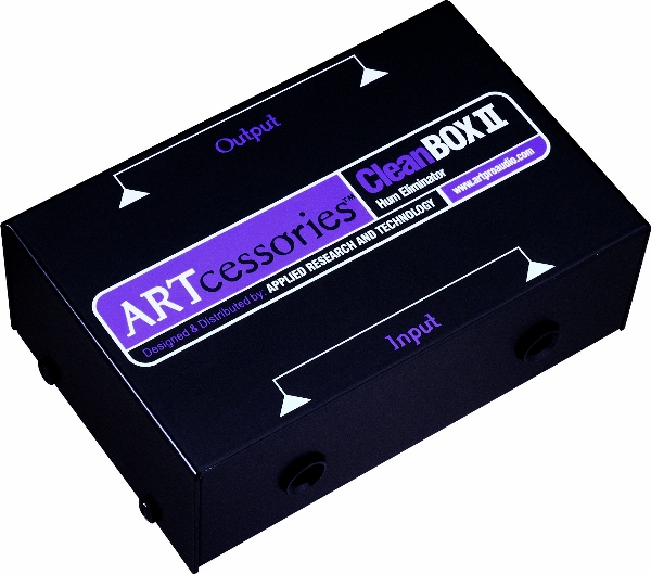

I was under the impression the 1/4 inch outputs on the RMX are unbalanced as well. Something like this would allow for the connection your looking for, along with giving you more control over the sound quality.

@Dazmax: In my manual on page 7, section 4.2 (The connectors) "Pro gear 1/4 jack output connectors 1-2 (4dbu) unbalanced".
And thanks again, I tried borrowing a DI box and it worked fine! Guess I'll buy one soon.
@Tearemup: Thanks for the advice! I'll look into it, even though my goal here is to have to bring as little equipment as possible :)

Learn something new every day I guess. Apologies for the incorrect information and thanks for checking the manual for me.
Here are a couple of DI box Ideas for you.
Both of these will convert from Unbalance to balanced and as they ar passive designs they do not require batteries or an external power supply.
Tearemup's idea with the graphic eq solves two problems and is well woth a look. This gives you the Unbal to Bal conversion and the ability to taylor your sound to suit different venues. It is well worth thinking about if you can deal with the extra size.
