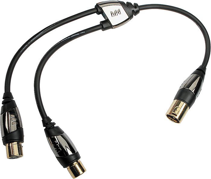

Why not run from the RECORD out from the 4 channel mixer to the AUX IN on the DDJ-S1? Then run the XLR out from the DDJ-S1 to the Amp?
The other option would be to get a \"Y\" splitter and connect the right channel of the DDJ-S1 and the right channel of the Mixer together into a single cable which would go to the right input of the amp. Repeat for the left channel. Assuming the mixer has XLR out as well, Guitar Center does sell an XLR patch cord that would be dual female to single male adapter.
http://www.guitarcenter.com/Monster-Cable-1-Male-to-2-Female-XLR-Y-Adapter-104847041-i1172771.gc?&source=4WFRWXX&CAWELAID=439925528
