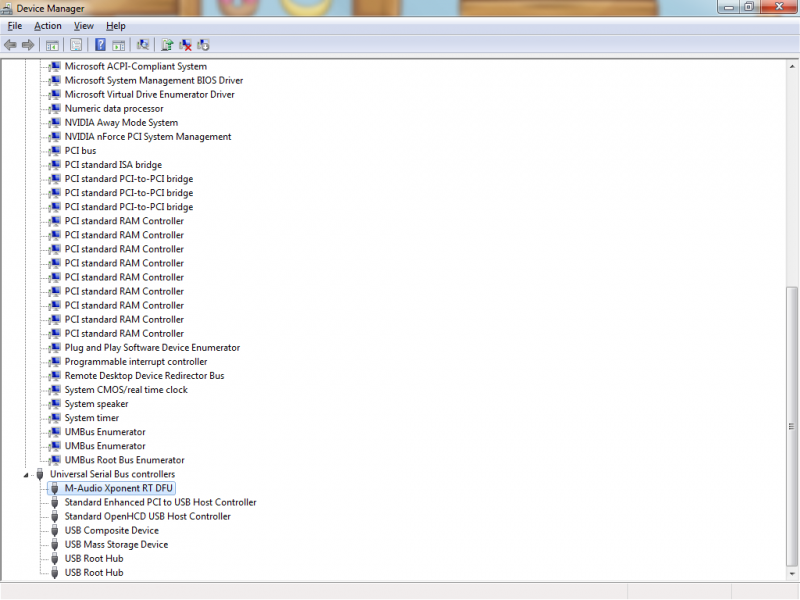

Shouldn't there be another device too - DFU rings a bell.
geposted Wed 21 Sep 11 @ 1:57 pm
might be, i have no clue

Is there a way to get the software to recognize the Xponent???

are you using 32 or 64 bit windows... check you installed the correct driver
geposted Wed 21 Sep 11 @ 7:45 pm
For some reason my xponent is not responding to the software.
I have tried windows xp machine
windows 7 machine
I get no response from the controller at all.
In the torq configuration sees the xponent drivers.
I get the same results if I use VDJ.
No lights when I put music on a or b
Please Help

is it pluged into the lappy or a usb hub, is the hub powered?
does the xponent have an ac adapter? is it working properly?
have you checked the usb setting in control panel -> power options
did you try a different usb cable
did you try a different usb port?
when I used connectiv it installs the driver only on that usb port it's connected to, if i removed it, I needed to reinstall it and restart the pc

I use a power cord. Everything is is working. I don't know what went wrong.
windows 7 machine
Please Help
windows 7 machine
Please Help
The settings "A" SBDJ mentioned is the switch in front of the Xponent (with options A or B)
Without my knowledge somebody changed mine to "B" long time ago and I thought it was a software or computer problem too.
