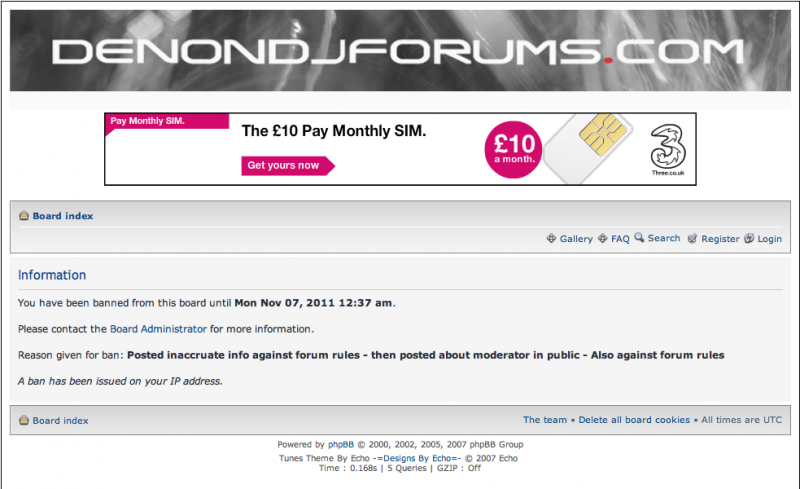

The mod on the forum that seems to have attitude with me is Gary, I haven't got far enough to meet the rest of them.
The truths the truth, I'll be speaking to Denon tomorrow about it.
geposted Mon 31 Oct 11 @ 2:54 pm
Charlie,
There is nothing Denon can do as the forum is not owned or endorsed by them. they use it as a "free" way of support but it's not official. I had a chat with D&M UK in Belfast about it earlier this year as I was enraged about what happened to me (with the same mod I must add).
Silvio offers support in the States which makes the site look like it is ran by Denon but D&M (who were extremely helpful) have confirmed other ways.
Keith
Keith
geposted Mon 31 Oct 11 @ 4:05 pm
