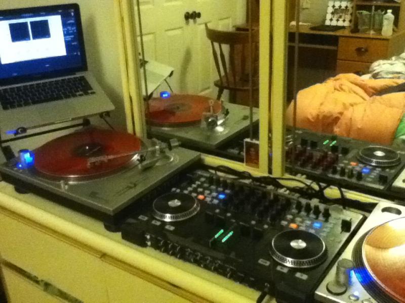

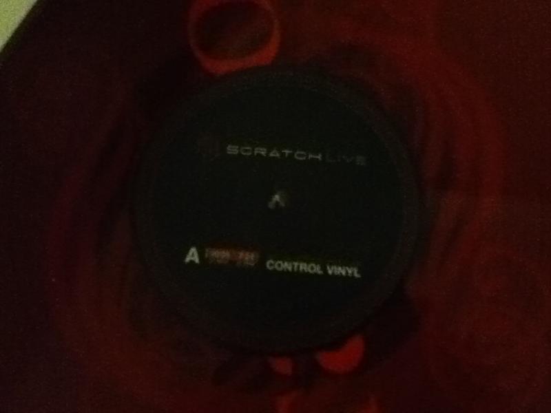

So I have my VMS4, Macbook with VDJ 7 Pro, Stanton Str8-60 turntables, and Serato Scratch live control vinyl and I'm not receiving a timecode signal! All my connections are correct, all my settings are correct, and I'm doing everything I should so I have no idea why it's not working. I get into timecode configure and when I start my turntable, I don't get a circle or a signal showing up in the software. I'm getting the ringing noise but not any signal in VDJ from either of my decks. I've tried looking for answers, changing settings, and everything I could think of but nothing has helped. I was questioning if I got the wrong control vinyl but I'm pretty sure I got the right one, a pic of that is below. A fast response would be really appreciated! Thanks!

Yeah, I checked your thread out already, nice job by the way. The thing is, I'm using the Second Edition Rane Serato Scratch Live Control Vinyl but I'm not getting a signal AT ALL. Like I'm not getting a circle or anything. I have no idea what to do now...

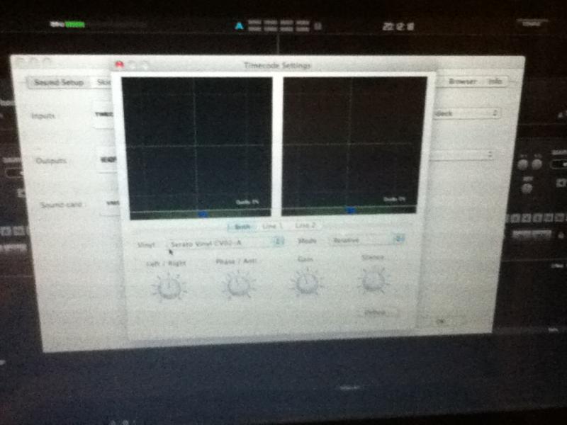

Yeah. The picture here shows the signal picking up on my VMS4 just fine. I can move the platter, move the crossfader, and move the volume faders and it will show on my volume bars the signal going up and down as it should. Then on the computer you can see there is no signal there at all in VDJ.

In this picture you can see clearly that there is no signal in Virtual DJ but when the picture was taken the VMS4 was receiving the signal with no problem whatsoever.

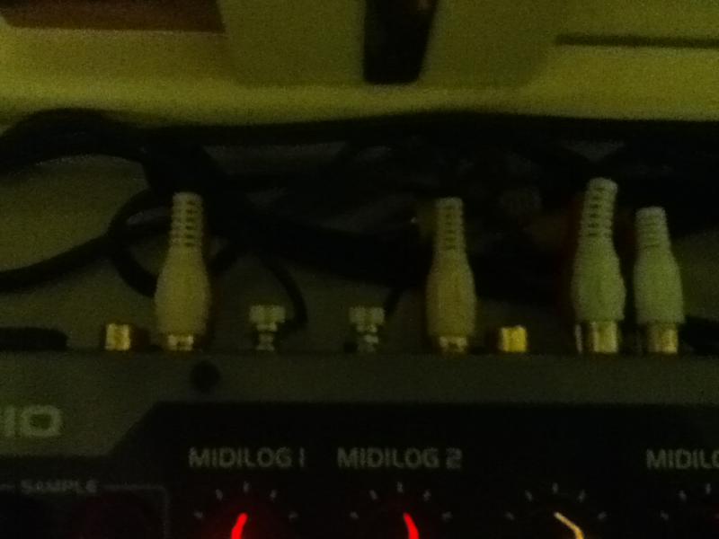

Then in this one you can see where my RCAs are plugged in. The two on the very left are the master out and the booth out so ignore those. Then on both sides of the grounds you have where the RCA from the turntables are. Then you can't see it by the picture but the switch is on phono.
