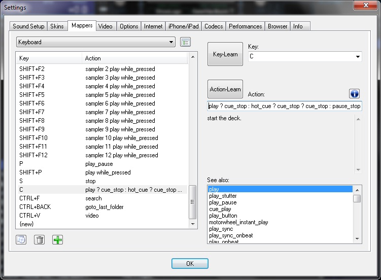

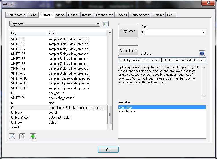

Thanks mate - depending on the club/room i\\\'m in, I\\\'m, using either CDJ2000, CDJ850 or AA DP2 controllers.
Here at home it\\\'s just the skin, so this is what I\\\'m experimenting on.
So I\'ve pasted that string into the cue command as per the screen grab - it doesn\'t work. Cue point 1 gets over written if you pause, and then press cue.
Cheers

Try the first one, the one you've tried is for skins not mappings.
play ? cue_stop : hot_cue ? cue_stop ? cue_stop : pause_stop : cue_stop
It definitely works, I have used these strings for months.
Keith
Keith
geposted Mon 03 Dec 12 @ 1:24 pm
