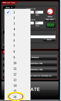

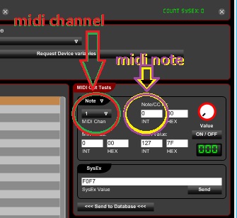

I'm not too good at defining yet sorry ceser, but I have been using chackl's tool to test the leds. if you input the results in those boxes, do you get access to the different colors?
click the picture to go to the definer
Also have you tried adding the different channels to the definition? from what I remember they were all sending the same message, just on different channels
<led note="0x0A" channel="12" name="PFL_1" deck="1" />
<led note="0x0F" channel="12" name="PFL_2" deck="2" />
<led note="0x19" channel="12" name="PFL_3" deck="3" />
<led note="0x1E" channel="12" name="PFL_4" deck="4" />
(not sure if that is the right channel, I'll check in the manual)

Hi Andrew (Synthet1c),
I have tried putting the values of the led on space you have highlighted as i'm using the midi definer by c.hackl, i love to use this in defining midi address because it shows the channels correctly and it is almost look like the same to what i have used in defining midi notes on my synths & my sequencer when i was on the band during 90's and just copy & paste the value and the exact line to the VDJ scripts it helps less of typing the whole scripts. Now following to your instruction i was able to access the colors on all the boards of the xone dx but the CUE/THRU "PFL" & LINEIN just see "RED" only i tried to access the "GREEN" when i open the ITCH and trigger the midi notes of that by using the definer but it show the same values as i have used on RED. Now going back to the manual, i remember when i'm doing the channel gain level meter which contains 4-LEDS with different colors (green on -3dB, blue on 0-dB, yellow on +3-dB, red on peak-dB) the first try i have was focusing on "GAIN" it lights up the led but not blinking on the beat, it increases the lead amount to blue or goes up yellow when i'm increasing the gain of the channels, since i was not happy with it i tried then, i have added on my scripts the "blink" with value it doesn't work then i have tried the scripst which was on the VDJ wiki sites and many option from there but it doesn't work. Going back to allen & heath and ask from where channel gain come from? and they told me that allen & heath uses that as levels not gain so i went back to my scripts and change it to "get level" on my mapping instead of "deck 1 gain" now just changing the "gain" command to "level" on my scripts it makes a lot of difference now it is working great with the 4-colored lights blinking when the gains of the channels goes up.
Now my point here is to give you a background that maybe again i'm on the wrong side of my scripting where i'm focusing on "LINEIN" while allen & heath said to me that they have that as "THRU" where you can use the inputs to plays some audio device like CD player/phone/ect. and monitored it in the softwares. Does VDJ has this verb "THRU"? or do you have some thoughts on this? Otherwise i'll have to leave it the way it was. Thanks you again Bro.
