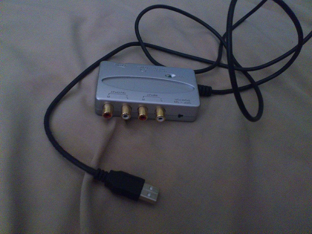

i dont use an ext s/c, i never have. but i do have an usb s/c. check out the pic below
i have used this b4 and yes it was a success for recording with audacity.
but if i can use my in built sound card would b cool, if i cant well i will invest in a decent usb s/c
