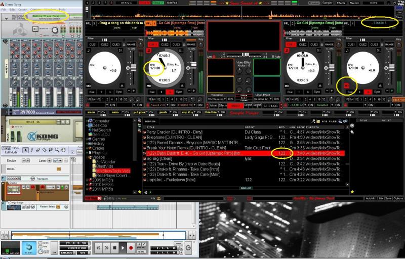

I think you forget VDJ will sync in two different ways................1 being that it uses the grid and 2 it will match the tempo of the other track (which is how I beleive it sycns from a line-in)
As you can see in my picture I have deck 4 as my MASTER deck (playing) and I hit sync on deck 1 and it matched up to deck 4 which is the deck I have REASON playing through.........NOW I drop the beat in myself so it does match up..........but if I tried to use "Sync_play" I dont think itd work cause there is no grid for it to match up too..............
Alls I can say is to try it yourself and youll see it VDJ will MATCH the BPM of the REWIRED deck, now yes mine does fall out of sync but not as fast as the OP.............

.....but as both you and the OP have said, it doesn't stay there! There's nothing for it to lock to, because the LineIn has no CBG.
And also as I keep saying, you're creating a loop by doing that. ReWire is one way - Master->Slave.
You've already made that connection by running Reason as a slave to VDJ. Now you're trying to slave VDJ back to Reason. You can't!

VDJ hasn't yet reached the stage where it can perform all these tricks. Maybe in version 8 we'll get something.....
