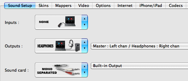

Using your built-in 3.5mm macbook headphone out jack like the way you wanted will work on mono split channel, your master out will be the white RCA (assigned Deck A) and your heaphone will be the RED RCA or (assigned as Deck B). But you have to setup in VDJ sound config by selecting your soundcard with mono split channel (that is with pictos that shows Speaker on the other side and Headphone on other side). See the screen shot below.
