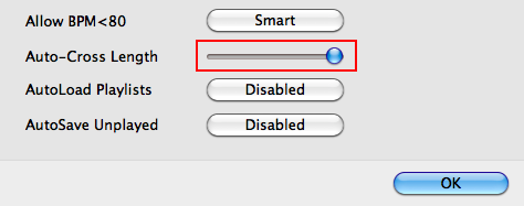

How do I slow down the transition in automix? I've played with the autocross length all the way right and left. I read somewhere that force fade needs to be on, but I don't see where I'd do that either.
I've read the manual and looked all the through the forums, but just can't seem to find the place to configure the settings to slow down the transition.

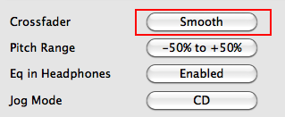

You maybe switch your crossfader function off or cut thats why transition is not smoother or slower, try to set in smooth and have a longer transition. Try this combination below and see how it works:

Thanks so much. Really appreciate that screenshot! I made those changes, but it still seems to transition too fast.. thoughts?

Essentially, the automix length is too rushed (fast) to sound natural and I'd like to slow that down a bit.

You only can change the Automix Length at Automix setup (page19 on manual side)
This in combination with the used Automix Length and the track itself is the result.
There is no "one" solution for all types of tracks and situations.
