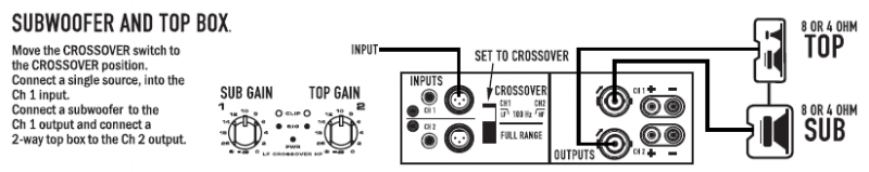

For the distortion, you may be over driving the inputs to your amp's or running to much power into your speakers. Or it may be to much bass going to your full range cabinets and high going to your subs. Did you set up the amps like suggested in your previous post? You'll still need to split that up and use the crossovers in your amp. If you do that, you should only need the main out on the XENYX

I just looked at the User Manual for the QSC amps, I\'m guessing you have a GX series, the back looks the same. You do not even need the splitter. Flip the switch and plug the Left Main out from your mixer into Channel 1 of one amp. Plug your full range into the Output CH1, and the sub into Output CH2. Do the same with the Right Main Out and the other amp and speakers.

Thank for the help blk, I really appreciate it.
What I had set up wrong was the speaker wires that go into the amps. I had one sub wire and one amp wire going into each amp. I made it so one amp has both subs, and the other amp has both speakers.

I don't see how you are getting the crossover feature this way. Have you tried to do it how I explained? It will sound better and you won't beat your tops as hard with low end. You shouldn't have 4 wires going to the 2 amps, 1 wire for each amp.

The way I just told you I recently set it up to, is the only way it's been working. A Guitar Center told me to only have one amp control the subs, and the other control the speakers. Otherwise, I would need a crossover?

The guitar center guy was half right. But, you have a crossover built into your amp's. That's why I've been telling you to hook it up that way. It's not as good as an external, but it's better then how it's set up now.
