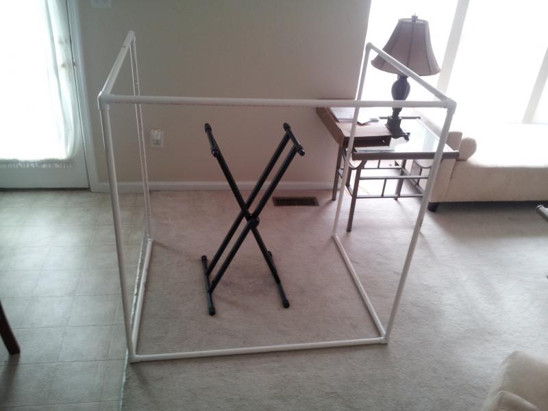

Thank you...
I plan on doing this project this weekend.
I plan on up-lighting behind the facade.
My facade will be 4ft high x 4ft wide x 3ft deep with white lycra or similar material.
If i'm not mistaken, I will need...
6 4ft pipes
4 3ft pipes
4 3way corners
4 right angle corners
pvc cement
2 3x4 sheets of lycra
1 4x4 sheet of lycra
Am I missing anything? I have never built anything like this before.
6 4ft pipes
4 3ft pipes
4 3way corners
pvc cement

Well....
That was quick and easy.
Now all I have to do is paint it and find the fabric and i'm done!
