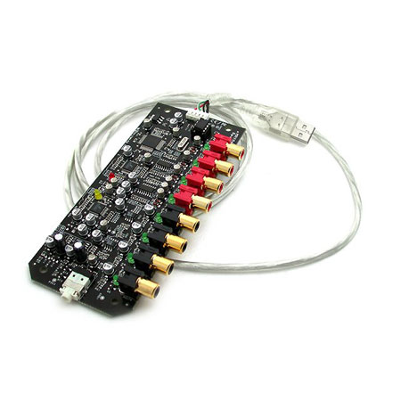

Thanks for the help. I tried setting stuff up but I encounter a problem. I got myself a Maya 44 USD external soundcard. I installed the latest drivers as well from their website. What happens however, is that the inputs from both channels / both players, go out the same OUT channel.
In detail, on the Maya, channel 1 and 2 IN receive the audio from the left player and channels 3 and 4 IN receive the audio from the right player. The same is the logic with the outputs: 1 and 2 OUT should get the sound from 1 and 2 IN and 3 and 4 OUT should get the sound from 3 and 4 IN. However, Both 1-2 and 3-4 IN go out the 1-2 OUT channel. I cannot find any settings in the control panel to fix this. Somebody with experience on this please advise so I can finally hook it up to VDJ.

the maya 44 usb is a cheap way of doing it.. it works ok but the quality of the actual box is crap.. I have one and would never go that way again. I also understand that it becomes wonkey after being pluged in and un pluged as you dj.. I had this issue and had to buy a new one.. My second one was upgraded to a better card and was able to be used as a pro recording studio in..
my suggestion is to check out one of the new contolers as they have line in and phono in and then have extras built in and are about the same price..

here is one thing i for got , when you burn your time codes. slow the time down as the faster burn more chance to have them skip. also buy a few different brands of cds. Some will play in cdjs some didnt and took me for ever to figure it out...
