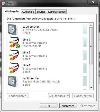

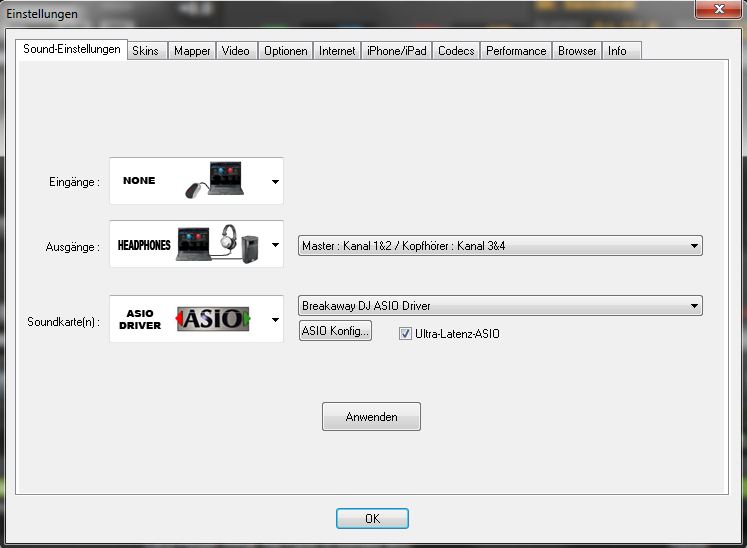

The settings should be:
Enjoy...;-)

Thanks!!!
I think thats what i have but I will check when i get home.......what preset do you use or do you go in and tweak the settings?
