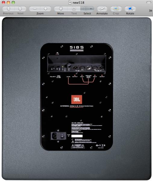

PC to mixer I believe is from the headphone jack into RCA and PC to midi controller would be USB.
From mixer/controller to sub would be XLR to XLR, 1/4" or RCA to XLR left and right....
Then out of sub XLR left and right into your tops as you can see by the rear of the sub here....

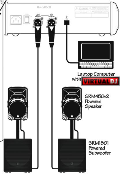

Heres a basic diagram from pc to mixer/midi controller into subs then into tops via XLR
geposted Sat 08 Dec 12 @ 8:11 am
