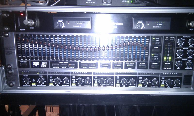

I have a hardware EQ in my sound rack. One of these actually Ultragraph Digital DEQ1024.
Picked one up on ebay for less that £100.
What I like about this EQ is:
I use this in conjunction with an Ultralink PRO MX882 which works great as I can chose whether each channel is an input or output and when I have used to to control multi room set ups, but also when doing karaoke I plug the my Xenyx 1204FX in to the Ultralink to keep the karaoke mics apart from the MC6000.
Again picked up the MX882 for less than £100 both brand new...
As can be seen here... Have upgraded the mics since...
- It's a stereo EQ with only one set of controls - so easier to configure
- It has a built in feedback destroyer which works great for weddings/karaoke when the mics need to be out front
- It has a built in limiter so even if some numpty comes up and maxes out all your hardware controls, it won't do any damage to the equipment down the line - also good where the venue has it's own sound limiter so you can set your maximum just below it's cut off
Cheers,
Roy

Would totaly agree with an offboard Graphic EQ. If for no other reason than a properly sorted software EQ, while usualy very flexible is an additional load on the computer that you just don't need.
As with Roy's setup these are easy to use and can be found at little cost. They dont tend to be heavy items. An added bonus is that most have the option of TRS and XLR balanced inputs and outputs but will accept single ended inputs from sound cards and mixers. You can then keep the single ended signal cables very short and run the more Profesional Balanced Line connections to your Powered Speakers :-) This helps with level matching and reduces the possibility of ground loops/hum and noise pickup problems with the long signal cables needed for powered speakers.
A 1/3rd octave EQ like this has some hidden tricks too. You can apply Verry low Frequency cut ie around the 20hz/30Hz bands to reduce amplifier power consumption/dissipation at frequencies that most speaker systems don't reproduce well (If at all). This can help tighten up the bottom end of your sound and extend amp/speaker life. There is very little usefull bass information below 30Hz appart from special effects in cinema film. But it uses a massive amount of amp power to reproduce anything in this frequency range. Unless you have a very capable and above all huge speaker system its not realy where the sound you want to re-produce is going to be.
The same can be done to a lesser extent right at the top of the frequency range ie 20KHz to help reduce power dissipation in the HF speaker drivers and protect them to some extent from extreme HF/Ultrasonic noise. As mentioned Feedback Control can be implemented by applying small amounts 3 - 6 db max of cut around realy troublesome frequencies.
Try to avoid the usual Smiley Face setting tho. It might sound good to you to start with but realy is not what an EQ is for. General rule is to use as little boost or cut as you can get away with.
Big Thumbs Up :-D
Daz
Big Thumbs Up :-D
Daz
