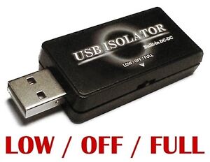

i finally received this in the mail only to found out this didn't work :'(
i may have to try DI Box, but the one you posted doesn't have USB input on it!?
