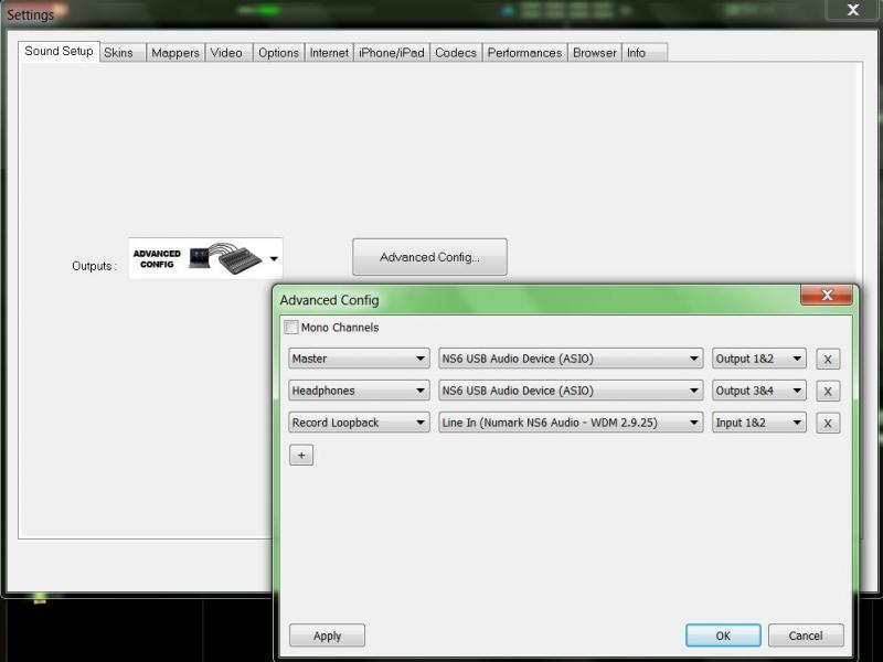

I use a Numark NS6 as my controller but I imagine the settings should be similar for your setup. Go into Config + Sound Setup + Advanced Config. Here's what mine looks like:
I hope this helps.
I hope this helps.

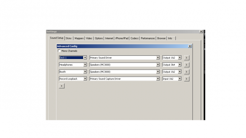

Got it to work somewhat, ran RCA's from the main output on controller to mic in on sound card. On the advanced config ran these settings:
Not happy with the sound quality, and have to keep the main output level on controller to less than 1. But the mike function properly from the controller. Any time I try to use ASIO driver I get an error... If anyone has a better way... I'm all headphones...
geposted Fri 04 Jan 13 @ 3:49 pm
First line on image should be Master,, change it by mistake while taking snap shot : )
