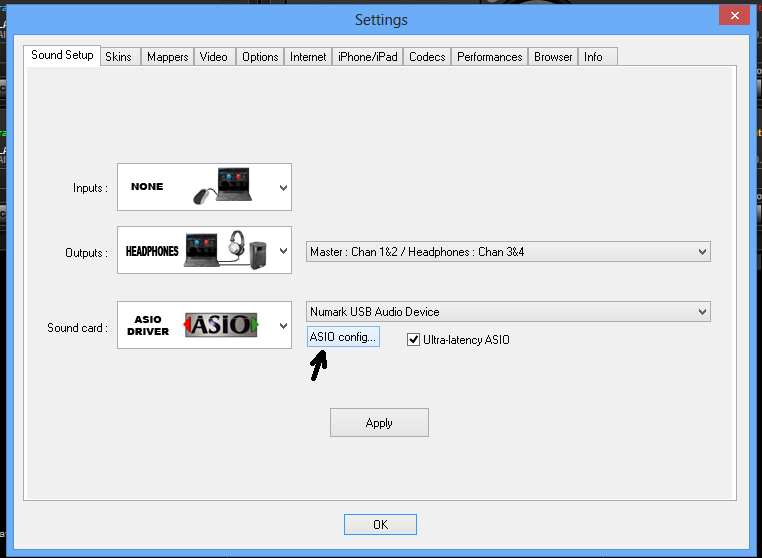

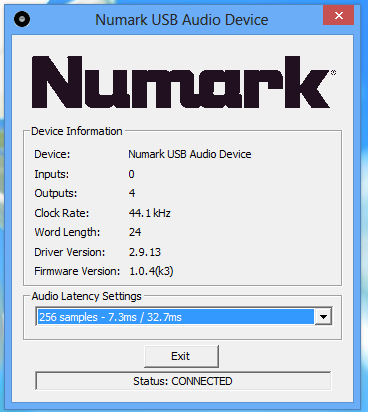

Hi
I have a numark DJ/IO and it works pretty good, but I have Windows 8 Pro
