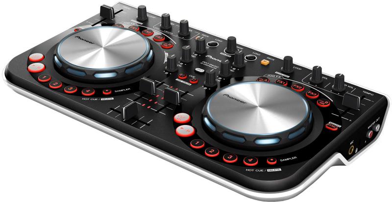

So I have 2 Numark V7s connected to my DJM 250 (DJM25 has XLR outs), and I also have a Numark N4 with XLR outs...my question is..I recently saw the Pioneer WE-GO, and they say its an entry level controller. But even with all my equipment, my eyes started drooling: Its so compact...has everything I need - hot cues,led visual eye candy(not necessary but eye candy non the less), ect... The fact that is so compact will save a ton of space in my backpack..sorry back to the question: Since it only has RCA outs, I was wondering if anybody here has used this cable ->
http://www.amazon.com/Monoprice-1-5ft-Plated-16AWG-Cable/dp/B001UJCS82/ref=sr_1_7?ie=UTF8&qid=1362015005&sr=8-7&keywords=RCA+to+XLR+male
If so..is the sound quality any different? Is the cable an ideal solution to virtually be able to hook it up to any sound system as most mixers and controllers can?
