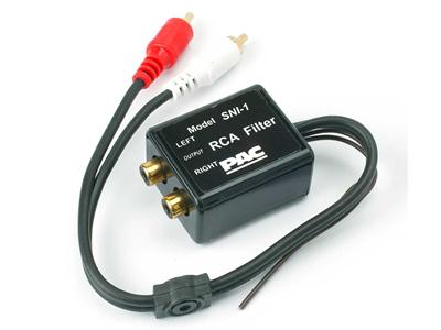

You need a GLI (ground loop isolator). They cost from around €7.

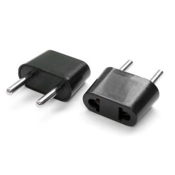

Presumably, your power supply is 3 prong, which includes a ground prong. Get a 2 prong adapter, connect to the power supply, and plug into a surge protector, and the problem is solved. This is known as "lifting the ground." The Wiki which is linked in the prior thread advises against removing or isolating the ground, but I believe this is something different. I've never experienced any danger since the 2 prong adapter is being plugged into a surge protector.

Yeah, for a good reason - your life.
If a product has a ground connection, it's there because it's needed. They didn't just add it for fun.
geposted Wed 20 Mar 13 @ 2:09 pm
A surge-protector is a peak (or over-voltage)-protector, and has nothing to do with grounding. It will NOT protect you from ground-malfunctions or the risk of being electrocuted...
geposted Wed 20 Mar 13 @ 3:35 pm

I had the same problem and after trying many things, it was a 2 prong adapter that saved me.
I am 90% certain this will solve your problem.

I use one of these to avoid the problem.
Very well worth the $ 15 that it cost.

+1 on using an Audio Isolating Transformer (AKA Ground loop isolator).
The fact you have interference means that you have power going down your audio cables. The Earth connection is likely keeping it at a safe voltage. I have measured dodgy Switchmode Power Supplies supplying 90VAC between the output and Earth. This will give you a mild shock not to mention potentially kill expensive PA gear. Don't risk your safety using 2 pin adaptors.

Cheers for all the replies here folks, tis appreciated :)
First answer in the postbag was a winner :)
Picked one of these up on eBay for £5 and it does the job perfectly :) Thanks again!!
