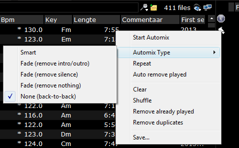

Hey everyone, I was wondering if there is a way to add a pause in automix. Some of my songs doesn't have any silence before the or after the song. So once the song the next song comes straight in and dosen't sound right. So I would like to add 10 sec's of silence after all songs if its possible.

I'm Only coming up with:
create a 10sec silence mp3 file and add it in between each songs.

Dang thats a simple and great idea I'm a roll with that one thanks @TheMagicDj

Hi Everyone,
I recognise that this thread is old, I'm hoping there will be some work around available now.
I mix tango music, sometimes with dubstep songs, sometimes classical.
For the classical songs transitions, I need to auto add 3-5 seconds of silence between tracks, for the dubstep, I mix the songs continuous.
Having to create a 3 second "silence" track to put between each song in the classical sets, is a real pain in the backside, it would be really helpful to be able to specify a silence of a set length in the automix settings "None (back-to-back)" option....
Is there any way to do this?

Thanks for linking bigchap, that is one route & with further work and track colouring it could be further automated.
geposted Fri 15 Jan 16 @ 12:16 am
Awesome feedback guys :) scroll down to the bottom of the linked thread to get code for a custom button to add silence between tracks :)
