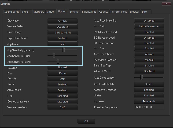

setting the sensitivity in the config window cant hurt either, but the default Scratch Latency is the most important

Jog sensitivity thats the ticket, baby!!! Synthet1c is dead on....

No luck. Tried both still need to try the old default latency setting on the registry tool and messing with the platter sensitivity on the pioneer.

Messed with the platter sensitivy knobs on ddjsx
