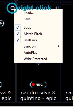

The gain of VDJ doesn't matter.. The samples are recorded from the source of the samples so retain the original gain independent of VDJ. If you want level samples you need to use a program like mp3Gain to normalize and limit all the sounds before you sample them.
If you are using existing songs or producer sample packs you need to record them into the VDJ format before you use them properly. To do this you can find the sample in your library and load it onto any deck..
Next you need to set the beatgrid of the sample. To do this you can right click the bpm button which will bring up a window where you can enter and modify the bpm and beatgrid information manually.
Once the beatgrid has been set successfully you need to loop the track for as long as the sample you want to record will be, you can correct the size and position of the loop with the controls on the skin, then press record on the selected sample slot (the track doesn't have to be playing).
The last step is to save the sample you have just recorded as if you miss this step, the sample will be deleted when you exit the program.
When you are playing samples if you want them to sync up you need to be playing a track on any of the decks and make sure it is selected as the master. Then make sure you select 'looped', 'match pitch' and 'beatlock' in the sampler drop down menu. see below
save the sample
