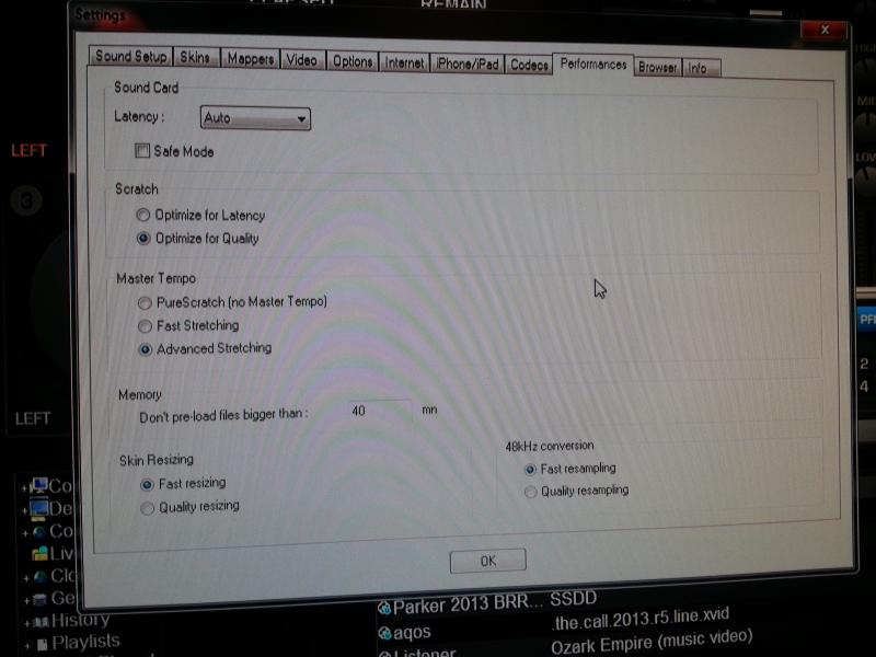

Latency has gotten a little better but still a little digital. Removed the slicer commands and led_volume. Also I have 4 deck skins. Let me know what I can do to improve the sound. Vdj worked fine with my denon mc3000.
geposted Sun 30 Jun 13 @ 9:06 pm
This is working for me. I use PureScratch when I'm not going to be do major tempo changes.
geposted Sun 30 Jun 13 @ 9:34 pm

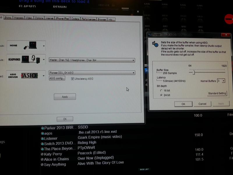

I've been told to run it at 16bit.
geposted Mon 01 Jul 13 @ 12:34 pm
Changed up the settings. I am not sure where to change it from 24 to 16 bit due to running a Mac.
geposted Mon 01 Jul 13 @ 9:39 pm
Not at all familiar with macs. Isn't there a way to access your sound card via pioneers driver? Being that its a mac should def try the default map after the problem is resolved though. Haven't heard anyone having my issue on a mac.
