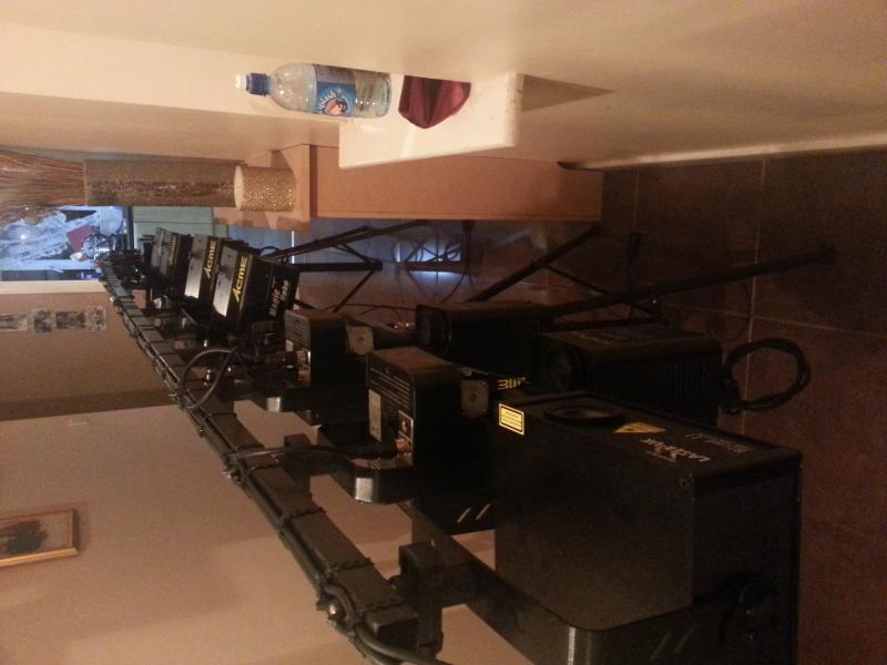

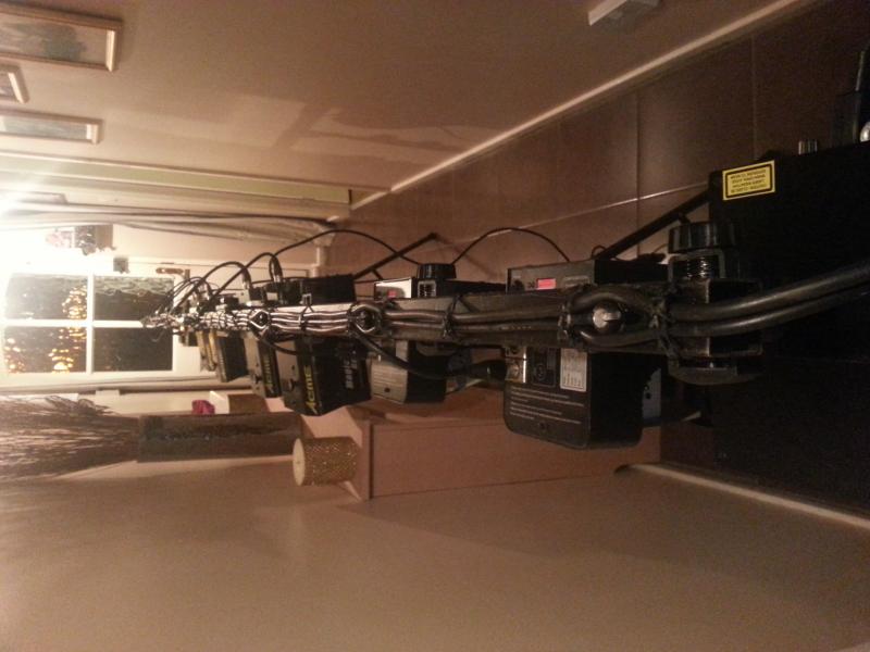

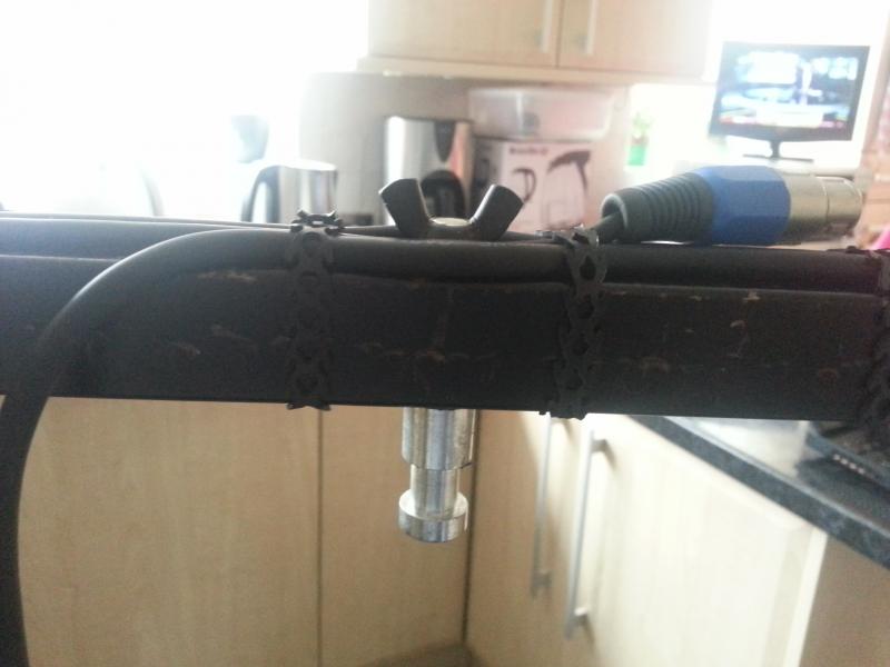

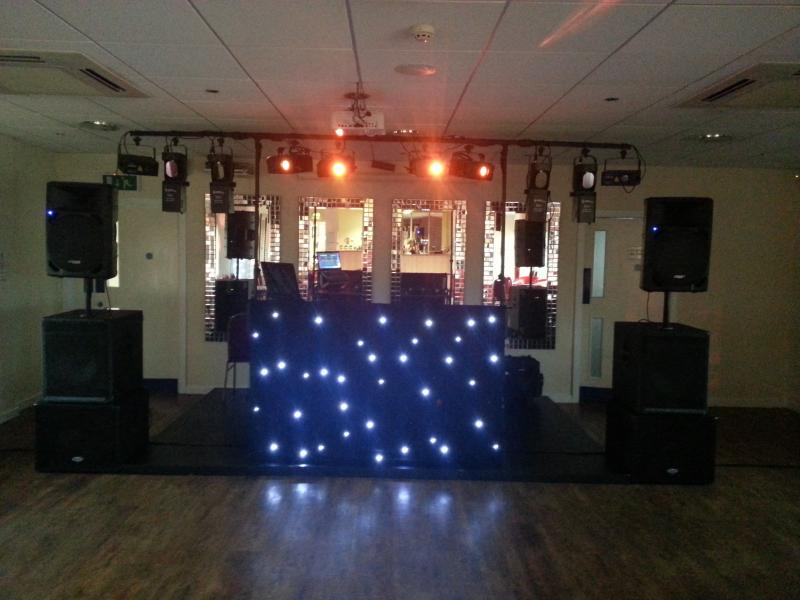

I've just switched to Rhino Quick Clamps - See here for demo...
Must have saved me a good 40mins combined set up/breakdown time now, as I've also been able to pre-wire my T-bars to I just click, tighten, plugin now...
Up close without a light attached
My "loomed" T-bars
View with the lights connected via the quick clamps
And full show using the above.

Worth noting that in some countries (Including the UK) H & S people like to see safety chains between each light unit and the Bar as an extra Just in case. Especialy if the Lights are suspended over the Punters.

It's a Giraffe 6ft stand. Had it about 5 years now and is great. Only thing I would want to change potentially is to winches for the uprights, but since having the quick clamps, that has been less of an issue.
4ft just doesn't feel wide enough for me.
On the lower shelf I have my two 19" rack cases - one for sound the other for light control. The front and back of each make excellent storage trays filling up the space on the same level.
