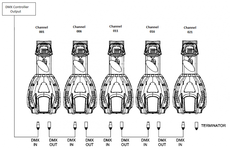

you connect like this
in the above example the lights are assigned as such,
each light uses 5 channels, so light one is assigned to channel 001..... this forces the light to use the first 5 channels of dmx.
the next light is therefore assigned to channel 6 as the first 5 channels are already used and any crossover in dmx assigning, causes behavioral issues with the fixtures.
if you use "freestyler dmx" for your control software, as you add your fixtures to your setup, it will show you which channel to assign each light to and also show the dip switch settings for each.
heres a link to the dmx wiki and a basic explanation of setting up your dmx dip switches
http://www.thedmxwiki.com/dmx_definitions/dip_switches
the wiki alson contains everything you need to know about dmx lighting systems
hope this helps, john.
