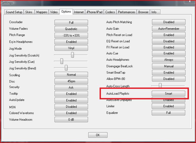

          load it to where???? if you mean pre select tracks and then have the list added to side/play list, then just build playlists pre performance, select the play list you have built and it will automatically load the entire thing to both play list and side list.
maybe im missing something , but i see no use in mapping keys to do the job of the selecting a play list by other means (mouse, keyboard, controller).

You can use the "switch_sidelist_playlist" action for the sidelist

@ djjb: Yep. Have that one turned on! Thank you anyway for the tip.
